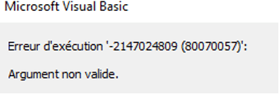

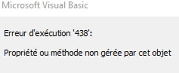

Manipulation n1:
Set oHTML = IE.document
        With oHTML
            oHTML.querySelector ("[href=javascript:gotoinforme('tablero/tbl25_frames.jsp','GRUPO1','TBL25B')]")
                            End With
Manipulation n2:
        With oHTML
                oHTML.execScript "gotoinforme('tablero/tbl25_frames.jsp','GRUPO1','TBL25B')", "JScript"
                End With
