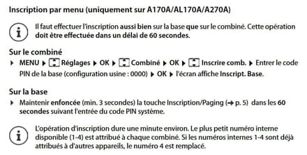

@baladur13
This manual is not for the A170 H, I always have a base that clicks and no button on the base!
So I went to menu / settings / handset / register handset, then I pressed the base button that makes the handset ring when you lose it for 3 seconds... it flashed and it worked... same thing with the other handset! -
Moderator@mamapasta
Of course, the A170H is the reference for the handset that goes with an A170 base (without answering machine) or A 170A (with answering machine).
You say: "no button on the base!" then: "I pressed the button on the base for 3 seconds"
Strange, did the button magically appear?
And you followed the procedure given in message #10...
Everything is working again, that's the main thing.
