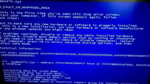

Bonjour à tous,
J'ai un petit problème, le voici :
Quand j'allume mon ordi (Windows 7), après le temps de chargement avec le logo, il m'affiche une page bleu contenant du texte (voir photo). Après qu'il soit a 100% il ne fait plus rien et je suis bloqué sur cette affichage. Néanmoins lorsque je le lance en MODE SANS ÉCHEC, il se lance.
Un bon samaritain pourrais m'aidé a résoudre se problème
Merci d'avance

    1. Merci bcp pour l'aide et désolé pour l'attente
      Voici le rapport de Who Crashed:

      On Sun 12/11/2017 16:52:19 your computer crashed
      crash dump file: C:\Windows\Minidump\111217-43836-01.dmp
      This was probably caused by the following module: aswmonflt.sys (0xFFFFF88005A47FC7)
      Bugcheck code: 0x50 (0xFFFFF8A003700000, 0x0, 0xFFFFF88005A47FC7, 0x0)
      Error: PAGE_FAULT_IN_NONPAGED_AREA
      file path: C:\Windows\system32\drivers\aswmonflt.sys
      product: Avast Antivirus
      company: AVAST Software
      description: Avast File System Minifilter for Windows 2003/Vista
      Bug check description: This indicates that invalid system memory has been referenced.
      This appears to be a typical software driver bug and is not likely to be caused by a hardware problem.
      A third party driver was identified as the probable root cause of this system error. It is suggested you look for an update for the following driver: aswmonflt.sys (Avast File System Minifilter for Windows 2003/Vista, AVAST Software).
      Google query: AVAST Software PAGE_FAULT_IN_NONPAGED_AREA

      Conclusion
      8 crash dumps have been found and analyzed. Only 5 are included in this report. A third party driver has been identified to be causing system crashes on your computer. It is strongly suggested that you check for updates for these drivers on their company websites. Click on the links below to search with Google for updates for these drivers:
