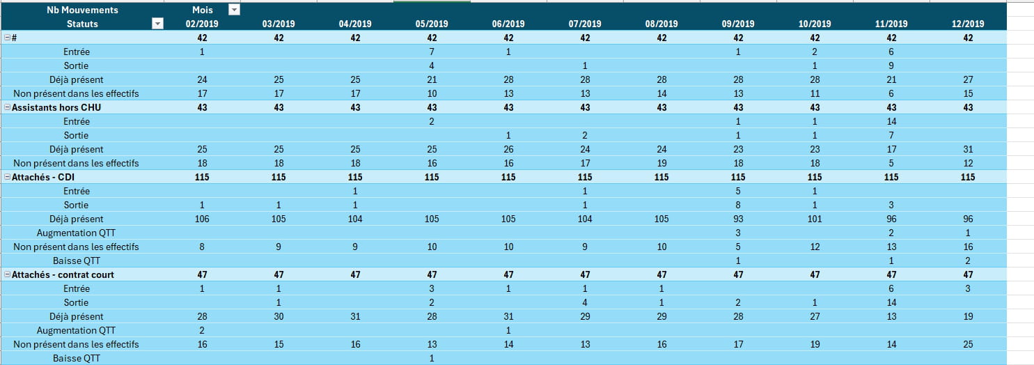

  1. Hello,
    Is this the kind of result?
    With Power Query, this is easily achievable (if you indeed have Excel version >= 2016)

  2. RE-,
    Or rather this?

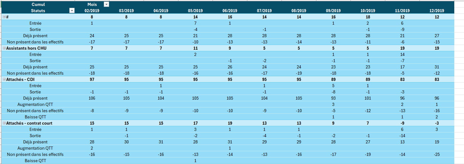

    2. @Jerome_aaaaarh
      I assign -1 if "Sortie" or "non présent", and +1 otherwise
      But we can end up with negative totals (Attached: short-term contracts, December 2019) for example

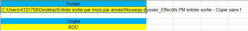

  4. Ok,
    In the attached file, in the "Param" tab
    - You enter the path and file name in cell A2
    - You enter the tab name in cell A5
    And in the "TCD" tab, right-click inside the PivotTable, then "Refresh"
    If you get an error message, you need to configure your Excel application (once and for all) by following the instructions in the "Read Me" tab
    1. Thank you very much,
      I configured my Excel as indicated, but it says the link is not found
      Nevertheless I did put my path + the file name and my tab
      Path = C:\Users\4121759\Desktop\Entrée sortie par mois par année\Nouveau dossier
      File name = Effectifs PM entrée sortie - Copie sans f
    2. @Jerome_aaaaarh
      The file name seems incorrect to me (it should end with xlsb or xlsx or...).
      Rename it to "Essai.xls?" (replace the question mark with the actual format—the one you had ended with xlsb).

      1. It’s indeed xlsb
        But it still doesn’t work. Maybe because I put an underscore between the path and the file name _Essai.xlsb
        C:\Users\4121759\Desktop\Entrée sortie par mois par année\Nouveau dossier_Essai.xlsb

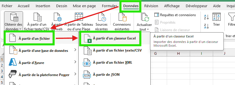

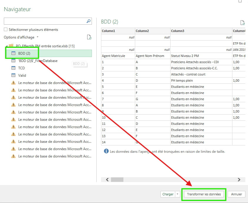

        1. Ok, we’re going to do a trick to properly retrieve the right file
          In Excel, you click on "Data/From a file/From Excel Workbook"
          You search for your file, then the tab, and "Transform Data"

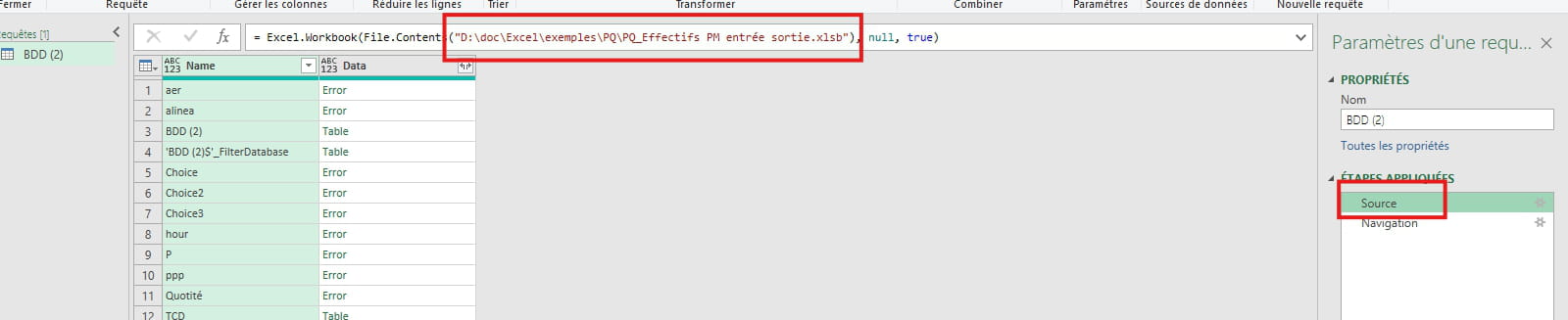

           And in the editor, step "Source", you retrieve the path and the name:
          And you paste this info into cell A2 (without the quotes)

          I only have "modifier" (edit), I don’t have "transformer" (transform)
        5. @Jerome_aaaaarh
          That’s good too (it depends on the version of Excel)
          Click on it, then retrieve the full name in the "Source" step
