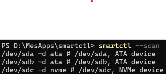

        # Scan des disque
        smartctl --scan

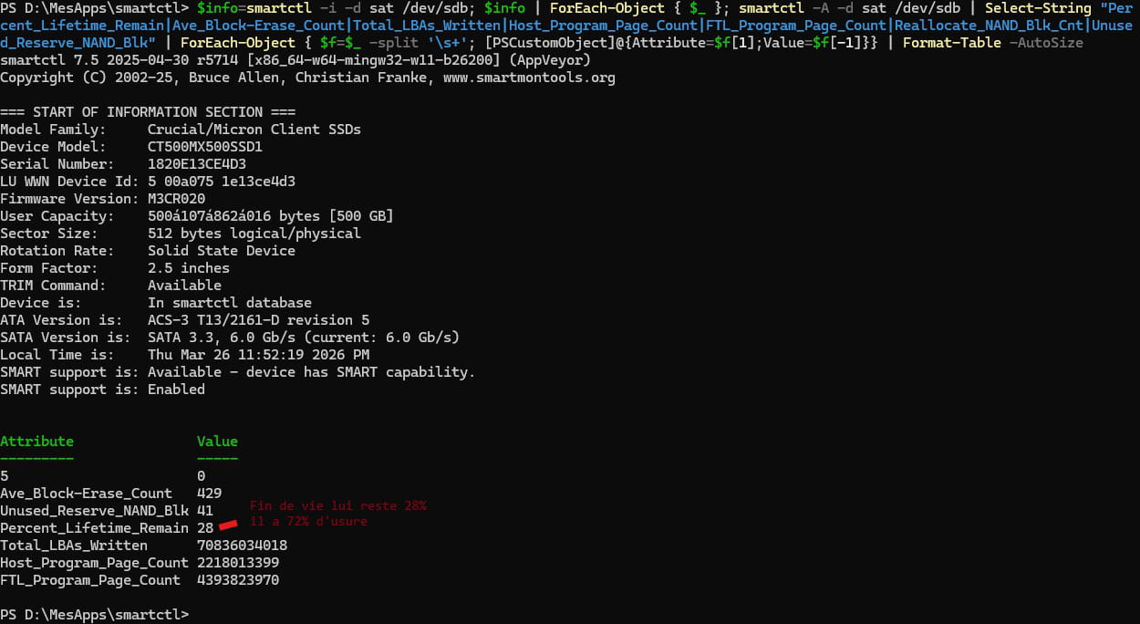

        # SSD
        $info=smartctl -i -d sat /dev/sdb; $info | ForEach-Object { $_ }; smartctl -A -d sat /dev/sdb | Select-String "Percent_Lifetime_Remain|Ave_Block-Erase_Count|Total_LBAs_Written|Host_Program_Page_Count|FTL_Program_Page_Count|Reallocate_NAND_Blk_Cnt|Unused_Reserve_NAND_Blk" | ForEach-Object { $f=$_ -split '\s+'; [PSCustomObject]@{Attribute=$f[1];Value=$f[-1]}} | Format-Table -AutoSize

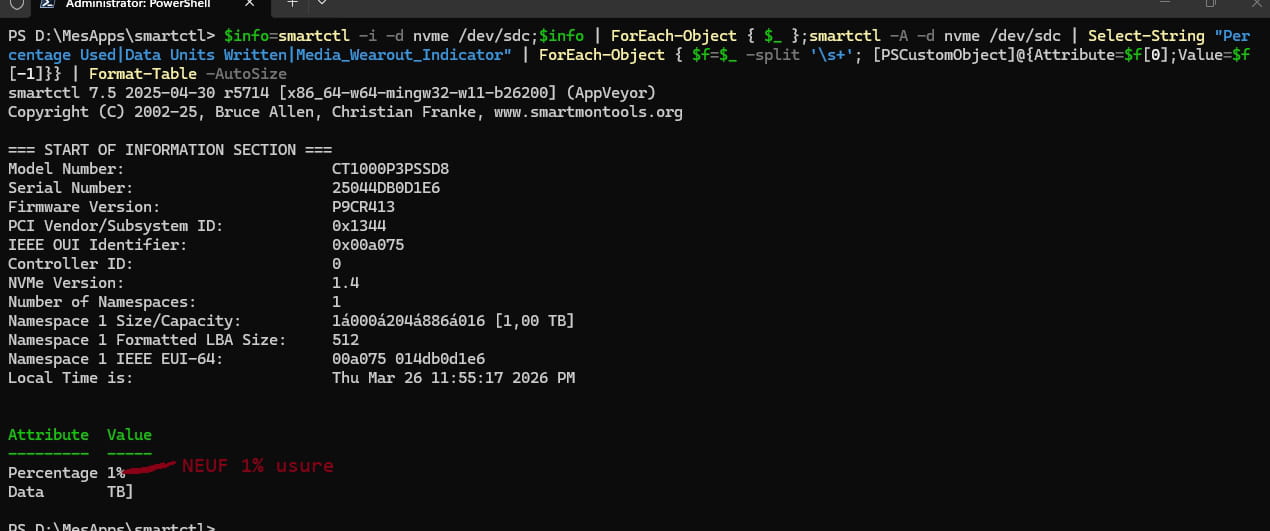

        # NVME
        $info=smartctl -i -d nvme /dev/sdc;$info | ForEach-Object { $_ };smartctl -A -d nvme /dev/sdc | Select-String "Percentage Used|Data Units Written|Media_Wearout_Indicator" | ForEach-Object { $f=$_ -split '\s+'; [PSCustomObject]@{Attribute=$f[0];Value=$f[-1]}} | Format-Table -AutoSize

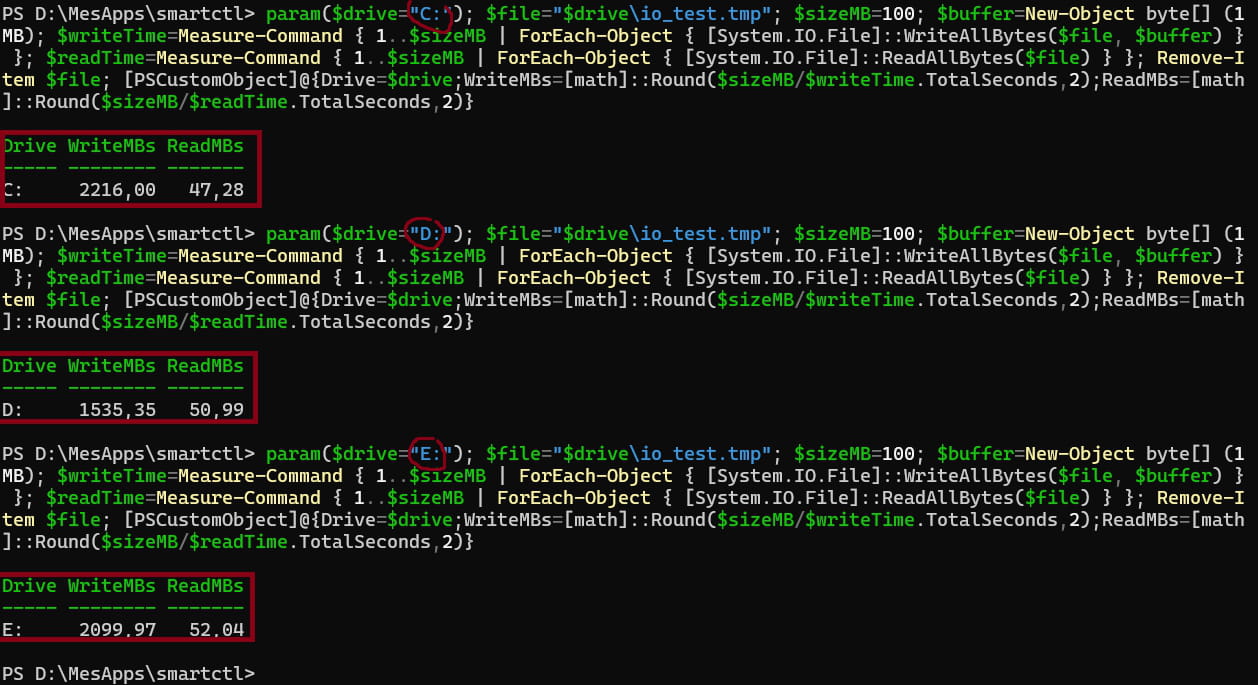

         Test de lecture écriture sur C:\ si tu veut allez + loin:
        param($drive="C:"); $file="$drive\io_test.tmp"; $sizeMB=100; $buffer=New-Object byte[] (1MB); $writeTime=Measure-Command { 1..$sizeMB | ForEach-Object { [System.IO.File]::WriteAllBytes($file, $buffer) } }; $readTime=Measure-Command { 1..$sizeMB | ForEach-Object { [System.IO.File]::ReadAllBytes($file) } }; Remove-Item $file; [PSCustomObject]@{Drive=$drive;WriteMBs=[math]::Round($sizeMB/$writeTime.TotalSeconds,2);ReadMBs=[math]::Round($sizeMB/$readTime.TotalSeconds,2)}
        Juste a remplacer la lettre du Lecteur exemples:
