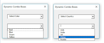

    How to create an Excel user form with dynamic combo boxes - VBA and VB.Net  Tutorials, Education and Programming Services
