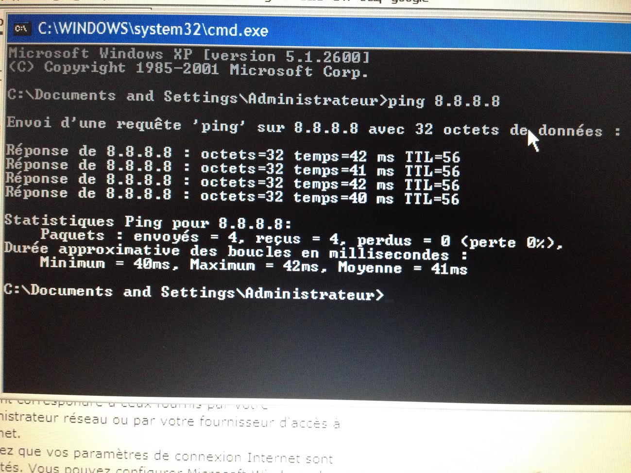

    1. voilà
      https://img4.hostingpics.net/pics/786061Capture.png
