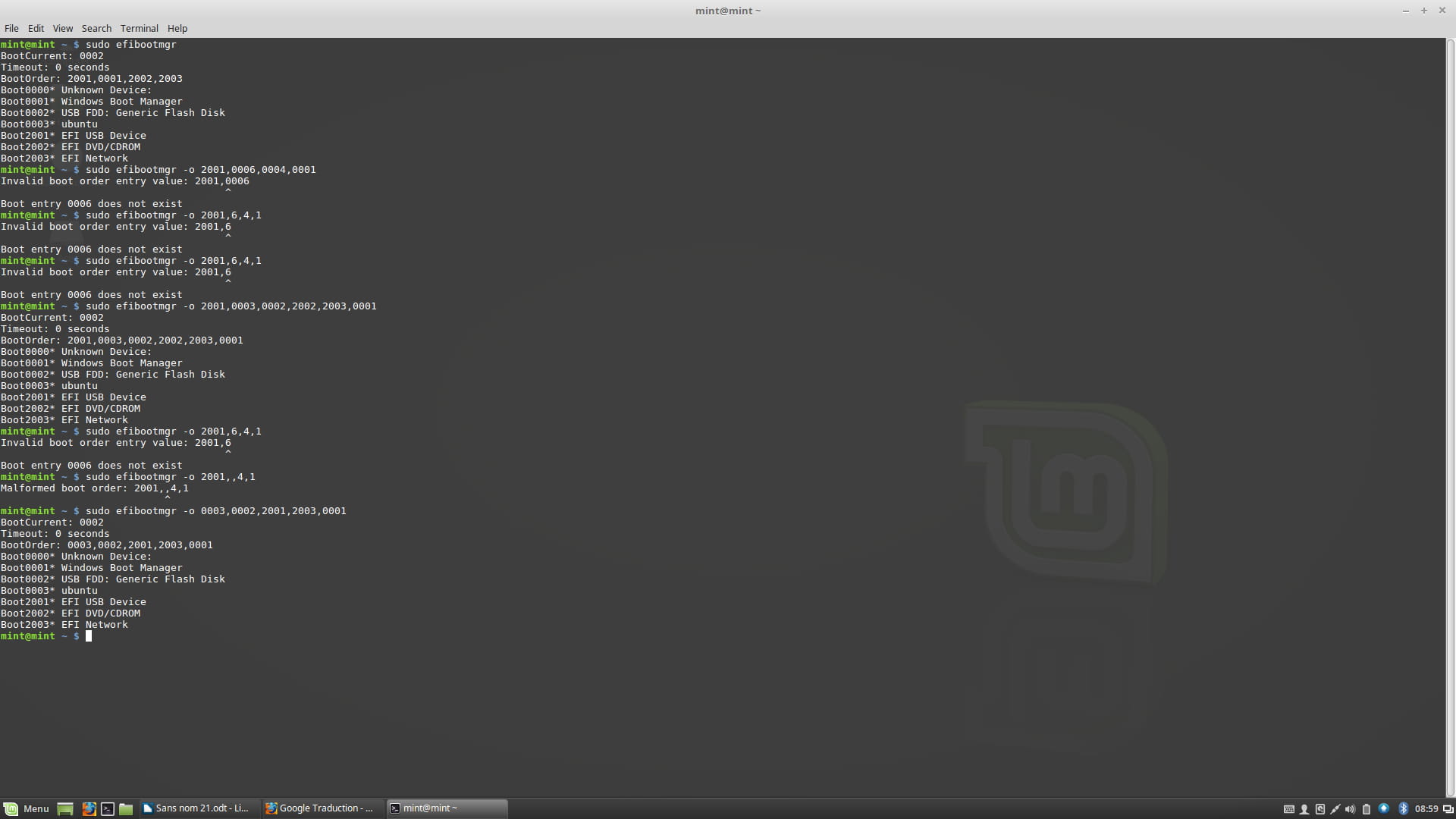

  4. Bonjour à tous j'ai fair un rapport boot info , voilà ce que cela à donné: Boot Info Script cfd9efe + Boot-Repair extra info [Boot-Info 26Apr2016]
    ============================= Boot Info Summary: ===============================
    => No boot loader is installed in the MBR of /dev/sda.
    sda1: __________________________________________________________________________
    File system: vfat
    Boot sector type: Windows 8/2012: FAT32
    Boot sector info: No errors found in the Boot Parameter Block.
    Operating System:
    Boot files: /EFI/Boot/bkpbootx64.efi /EFI/Boot/bootx64.efi
    /EFI/ubuntu/MokManager.efi /EFI/ubuntu/fwupx64.efi
    /EFI/ubuntu/grubx64.efi /EFI/ubuntu/shimx64.efi
    /EFI/Microsoft/Boot/bootmgfw.efi
    /EFI/Microsoft/Boot/bootmgr.efi
    /EFI/Microsoft/Boot/memtest.efi
    /EFI/OEM/Boot/bootmgfw.efi /EFI/OEM/Boot/bootmgr.efi
    /EFI/OEM/Boot/memtest.efi

    =============================== sda5/etc/fstab: ================================
    # /etc/fstab: static file system information.
    # Use 'blkid' to print the universally unique identifier for a
    # device; this may be used with UUID= as a more robust way to name devices
    # that works even if disks are added and removed. See fstab(5).
    # <file system> <mount point> <type> <options> <dump> <pass>
    # / was on /dev/sda5 during installation
    UUID=8b0e258d-cdd7-40b9-b9af-dcba69894cd0 / ext4 errors=remount-ro 0 1
    # /boot/efi was on /dev/sda1 during installation
    #UUID=BE0A-462E /boot/efi vfat umask=0077 0 1
    # swap was on /dev/sda6 during installation
    UUID=167e531e-2f31-4e00-bb2c-d110af72e5b5 none swap sw 0 0
    UUID=BE0A-462E /boot/efi vfat defaults 0 1
    =================== sda5: Location of files loaded by Grub: ====================
    GiB - GB File Fragment(s)
    98.374885559 = 105.629229056 boot/grub/grub.cfg 1
    98.381477356 = 105.636306944 boot/vmlinuz-4.4.0-53-generic 1
    98.381477356 = 105.636306944 vmlinuz 1
    110.896938324 = 119.074680832 boot/initrd.img-4.4.0-53-generic 1
    110.896938324 = 119.074680832 initrd.img 1

    =================== os-prober:
    /dev/sda1@/efi/Microsoft/Boot/bootmgfw.efi:Windows Boot Manager:Windows:efi
    /dev/sda5:Linux Mint 18.1 Serena (18.1):LinuxMint:linux
    =================== blkid:
    /dev/sda1: LABEL="ESP" UUID="BE0A-462E" TYPE="vfat" PARTLABEL="EFI system partition" PARTUUID="f88e631a-db6c-4eb5-af01-09b0ac6bcafc"
    /dev/sda3: LABEL="Acer" UUID="D6080E1D080DFCED" TYPE="ntfs" PARTLABEL="Basic data partition" PARTUUID="23c5a9b6-3a6d-4fd1-a6ff-d41f437a6994"
    /dev/sda4: LABEL="Recovery" UUID="D6B60ED8B60EB94F" TYPE="ntfs" PARTLABEL="Basic data partition" PARTUUID="00a68282-35a2-402a-8756-5109f2441706"
    /dev/sda5: UUID="8b0e258d-cdd7-40b9-b9af-dcba69894cd0" TYPE="ext4" PARTUUID="ad4d1858-4dca-40c2-973e-f48c9a79483a"
    /dev/sdb: LABEL="CLM-^P DE RORO" UUID="E608-D7A6" TYPE="vfat"
    /dev/loop0: TYPE="squashfs"
    /dev/sda6: UUID="167e531e-2f31-4e00-bb2c-d110af72e5b5" TYPE="swap" PARTUUID="8db78755-8c42-4a02-a02a-cb6e2eaccc24"
    /dev/sda2: PARTLABEL="Microsoft reserved partition" PARTUUID="217e874f-da88-4fb1-8f14-eef1e8165a3a"
    1 disks with OS, 2 OS : 1 Linux, 0 MacOS, 1 Windows, 0 unknown type OS.
    Windows not detected by os-prober on sda3.
    Presence of EFI/Microsoft file detected: /mnt/boot-sav/sda1/EFI/Microsoft/Boot/bootmgfw.efi
    Presence of EFI/Boot file detected: /mnt/boot-sav/sda1/EFI/Boot/bootx64.efi

    =================== efibootmgr -v
    BootCurrent: 0002
    Timeout: 0 seconds
    BootOrder: 2001,0001,2002,2003
    Boot0000* Unknown Device: HD(1,GPT,f88e631a-db6c-4eb5-af01-09b0ac6bcafc,0x800,0x32000)/File(EFIubuntushimx64.efi)RC
    Boot0001* Windows Boot Manager HD(1,GPT,f88e631a-db6c-4eb5-af01-09b0ac6bcafc,0x800,0x32000)/File(EFIMicrosoftBootbootmgfw.efi)WINDOWS.........x...B.C.D.O.B.J.E.C.T.=.{.9.d.e.a.8.6.2.c.-.5.c.d.d.-.4.e.7.0.-.a.c.c.1.-.f.3.2.b.3.4.4.d.4.7.9.5.}....................
    Boot0002* USB FDD: Generic Flash Disk PciRoot(0x0)/Pci(0x14,0x0)/USB(1,0)RC
    Boot2001* EFI USB Device RC
    Boot2002* EFI DVD/CDROM RC
    Boot2003* EFI Network RC
    =================== UEFI/Legacy mode:
    BIOS is EFI-compatible, and is setup in EFI-mode for this live-session.
    SecureBoot disabled. (maybe sec-boot, Please report this message to boot.repair@gmail.com)

    =================== Recommended repair
    The default repair of the Boot-Repair utility will reinstall the grub-efi-amd64-signed of sda5, using the following options: sda1/boot/efi,
    Additional repair will be performed: unhide-bootmenu-10s fix-windows-boot use-standard-efi-file
    /boot/efi added in sda5/fstab
    Quantity of real Windows: 1
    umount: /media/mint/Acer: target is busy
    (In some cases useful info about processes that
    use the device is found by lsof(8) or fuser(1).)
    Mount sda1 on /mnt/boot-sav/sda5/boot/efi
    ls sda1/efi: /OEM/Recovery/BCD.LOG2 /OEM/Recovery/BCD.LOG1 /OEM/Recovery/BCD.LOG /OEM/Recovery/BCD /OEM/Boot/zh-TW /OEM/Boot/zh-HK /OEM/Boot/zh-CN /OEM/Boot/tr-TR /OEM/Boot/sv-SE /OEM/Boot/sr-Latn-CS /OEM/Boot/ru-RU /OEM/Boot/Resources /OEM/Boot/qps-ploc /OEM/Boot/pt-PT /OEM/Boot/pt-BR /OEM/Boot/pl-PL /OEM/Boot/nl-NL /OEM/Boot/nb-NO /OEM/Boot/memtest.efi /OEM/Boot/ko-KR /OEM/Boot/kdstub.dll /OEM/Boot/kd_0C_8086.dll /OEM/Boot/kd_07_1415.dll /OEM/Boot/kd_02_8086.dll /OEM/Boot/kd_02_19a2.dll /OEM/Boot/kd_02_1969.dll /OEM/Boot/kd_02_15b3.dll /OEM/Boot/kd_02_14e4.dll /OEM/Boot/kd_02_1137.dll /OEM/Boot/kd_02_10ec.dll /OEM/Boot/kd_02_10df.dll /OEM/Boot/ja-JP /OEM/Boot/it-IT /OEM/Boot/hu-HU /OEM/Boot/fr-FR /OEM/Boot/Fonts /OEM/Boot/fi-FI /OEM/Boot/es-ES /OEM/Boot/en-US /OEM/Boot/el-GR /OEM/Boot/de-DE /OEM/Boot/da-DK /OEM/Boot/cs-CZ /OEM/Boot/boot.stl /OEM/Boot/BOOTSTAT.DAT /OEM/Boot/bootmgr.efi /OEM/Boot/bootmgfw.efi /OEM/Boot/BCD.LOG2 /OEM/Boot/BCD.LOG1 /OEM/Boot/BCD.LOG /OEM/Boot/BCD /Microsoft/Recovery/BCD.LOG2 /Microsoft/Recovery/BCD.LOG1 /Microsoft/Recovery/BCD.LOG /Microsoft/Recovery/BCD /Microsoft/Boot/zh-TW /Microsoft/Boot/zh-HK /Microsoft/Boot/zh-CN /Microsoft/Boot/uk-UA /Microsoft/Boot/tr-TR /Microsoft/Boot/sv-SE /Microsoft/Boot/sr-Latn-RS /Microsoft/Boot/sr-Latn-CS /Microsoft/Boot/sl-SI /Microsoft/Boot/sk-SK /Microsoft/Boot/ru-RU /Microsoft/Boot/ro-RO /Microsoft/Boot/Resources /Microsoft/Boot/qps-ploc /Microsoft/Boot/pt-PT /Microsoft/Boot/pt-BR /Microsoft/Boot/pl-PL /Microsoft/Boot/nl-NL /Microsoft/Boot/nb-NO /Microsoft/Boot/memtest.efi /Microsoft/Boot/lv-LV /Microsoft/Boot/lt-LT /Microsoft/Boot/ko-KR /Microsoft/Boot/kdstub.dll /Microsoft/Boot/kd_0C_8086.dll /Microsoft/Boot/kd_07_1415.dll /Microsoft/Boot/kd_02_8086.dll /Microsoft/Boot/kd_02_19a2.dll /Microsoft/Boot/kd_02_1969.dll /Microsoft/Boot/kd_02_15b3.dll /Microsoft/Boot/kd_02_14e4.dll /Microsoft/Boot/kd_02_1137.dll /Microsoft/Boot/kd_02_10ec.dll /Microsoft/Boot/kd_02_10df.dll /Microsoft/Boot/ja-JP /Microsoft/Boot/it-IT /Microsoft/Boot/hu-HU /Microsoft/Boot/hr-HR /Microsoft/Boot/fr-FR /Microsoft/Boot/fr-CA /Microsoft/Boot/Fonts /Microsoft/Boot/fi-FI /Microsoft/Boot/et-EE /Microsoft/Boot/es-MX /Microsoft/Boot/es-ES /Microsoft/Boot/en-US /Microsoft/Boot/en-GB /Microsoft/Boot/el-GR /Microsoft/Boot/de-DE /Microsoft/Boot/da-DK /Microsoft/Boot/cs-CZ /Microsoft/Boot/boot.stl /Microsoft/Boot/BOOTSTAT.DAT /Microsoft/Boot/bootmgr.efi /Microsoft/Boot/bootmgfw.efi /Microsoft/Boot/bg-BG /Microsoft/Boot/BCD.LOG2 /Microsoft/Boot/BCD.LOG1 /Microsoft/Boot/BCD.LOG /Microsoft/Boot/BCD /ubuntu/shimx64.efi /ubuntu/MokManager.efi /ubuntu/grubx64.efi /ubuntu/grub.cfg /ubuntu/fwupx64.efi /ubuntu/fw /OEM/Recovery /OEM/Boot /Microsoft/Recovery /Microsoft/Boot /Boot/bootx64.efi
    ls sda1: boot-sav
    EFI . Please report this message to boot.repair@gmail.com
                • lspci -nnk | grep -iA3 vga
    00:02.0 VGA compatible controller [0300]: Intel Corporation Device [8086:5916] (rev 02)
    Subsystem: Acer Incorporated [ALI] Device [1025:108f]
    Kernel driver in use: i915_bpo
    Kernel modules: i915_bpo
    grub-install --version
    grub-install.real (GRUB) 2.02~beta2-36ubuntu3.2,grub-install.
    chroot /mnt/boot-sav/sda5 efibootmgr -v
    BootCurrent: 0002
    Timeout: 0 seconds
    chroot /mnt/boot-sav/sda5 uname -r
    Kernel: 4.4.0-53-generic
    Reinstall the grub-efi-amd64-signed of sda5
    Installing for x86_64-efi platform.
    Installation finished. No error reported.
    grub-install --uefi-secure-boot : exit code of grub-install :0
    ls sda1: boot-sav
    df /dev/sda1
    Save and rename /mnt/boot-sav/sda5/boot/efi/EFI/Boot/bootx64.efi (/mnt/boot-sav/sda5/boot/efi/EFI/Boot/bkpbootx64.efi)
    cp /mnt/boot-sav/sda5/boot/efi/EFI/ubuntu/shimx64.efi /mnt/boot-sav/sda5/boot/efi/EFI/Boot/bootx64.efi
    ls sda1/efi: /OEM/Recovery/BCD.LOG2 /OEM/Recovery/BCD.LOG1 /OEM/Recovery/BCD.LOG /OEM/Recovery/BCD /OEM/Boot/zh-TW /OEM/Boot/zh-HK /OEM/Boot/zh-CN /OEM/Boot/tr-TR /OEM/Boot/sv-SE /OEM/Boot/sr-Latn-CS /OEM/Boot/ru-RU /OEM/Boot/Resources /OEM/Boot/qps-ploc /OEM/Boot/pt-PT /OEM/Boot/pt-BR /OEM/Boot/pl-PL /OEM/Boot/nl-NL /OEM/Boot/nb-NO /OEM/Boot/memtest.efi /OEM/Boot/ko-KR /OEM/Boot/kdstub.dll /OEM/Boot/kd_0C_8086.dll /OEM/Boot/kd_07_1415.dll /OEM/Boot/kd_02_8086.dll /OEM/Boot/kd_02_19a2.dll /OEM/Boot/kd_02_1969.dll /OEM/Boot/kd_02_15b3.dll /OEM/Boot/kd_02_14e4.dll /OEM/Boot/kd_02_1137.dll /OEM/Boot/kd_02_10ec.dll /OEM/Boot/kd_02_10df.dll /OEM/Boot/ja-JP /OEM/Boot/it-IT /OEM/Boot/hu-HU /OEM/Boot/fr-FR /OEM/Boot/Fonts /OEM/Boot/fi-FI /OEM/Boot/es-ES /OEM/Boot/en-US /OEM/Boot/el-GR /OEM/Boot/de-DE /OEM/Boot/da-DK /OEM/Boot/cs-CZ /OEM/Boot/boot.stl /OEM/Boot/BOOTSTAT.DAT /OEM/Boot/bootmgr.efi /OEM/Boot/bootmgfw.efi /OEM/Boot/BCD.LOG2 /OEM/Boot/BCD.LOG1 /OEM/Boot/BCD.LOG /OEM/Boot/BCD /Microsoft/Recovery/BCD.LOG2 /Microsoft/Recovery/BCD.LOG1 /Microsoft/Recovery/BCD.LOG /Microsoft/Recovery/BCD /Microsoft/Boot/zh-TW /Microsoft/Boot/zh-HK /Microsoft/Boot/zh-CN /Microsoft/Boot/uk-UA /Microsoft/Boot/tr-TR /Microsoft/Boot/sv-SE /Microsoft/Boot/sr-Latn-RS /Microsoft/Boot/sr-Latn-CS /Microsoft/Boot/sl-SI /Microsoft/Boot/sk-SK /Microsoft/Boot/ru-RU /Microsoft/Boot/ro-RO /Microsoft/Boot/Resources /Microsoft/Boot/qps-ploc /Microsoft/Boot/pt-PT /Microsoft/Boot/pt-BR /Microsoft/Boot/pl-PL /Microsoft/Boot/nl-NL /Microsoft/Boot/nb-NO /Microsoft/Boot/memtest.efi /Microsoft/Boot/lv-LV /Microsoft/Boot/lt-LT /Microsoft/Boot/ko-KR /Microsoft/Boot/kdstub.dll /Microsoft/Boot/kd_0C_8086.dll /Microsoft/Boot/kd_07_1415.dll /Microsoft/Boot/kd_02_8086.dll /Microsoft/Boot/kd_02_19a2.dll /Microsoft/Boot/kd_02_1969.dll /Microsoft/Boot/kd_02_15b3.dll /Microsoft/Boot/kd_02_14e4.dll /Microsoft/Boot/kd_02_1137.dll /Microsoft/Boot/kd_02_10ec.dll /Microsoft/Boot/kd_02_10df.dll /Microsoft/Boot/ja-JP /Microsoft/Boot/it-IT /Microsoft/Boot/hu-HU /Microsoft/Boot/hr-HR /Microsoft/Boot/fr-FR /Microsoft/Boot/fr-CA /Microsoft/Boot/Fonts /Microsoft/Boot/fi-FI /Microsoft/Boot/et-EE /Microsoft/Boot/es-MX /Microsoft/Boot/es-ES /Microsoft/Boot/en-US /Microsoft/Boot/en-GB /Microsoft/Boot/el-GR /Microsoft/Boot/de-DE /Microsoft/Boot/da-DK /Microsoft/Boot/cs-CZ /Microsoft/Boot/boot.stl /Microsoft/Boot/BOOTSTAT.DAT /Microsoft/Boot/bootmgr.efi /Microsoft/Boot/bootmgfw.efi /Microsoft/Boot/bg-BG /Microsoft/Boot/BCD.LOG2 /Microsoft/Boot/BCD.LOG1 /Microsoft/Boot/BCD.LOG /Microsoft/Boot/BCD /ubuntu/shimx64.efi /ubuntu/MokManager.efi /ubuntu/grubx64.efi /ubuntu/grub.cfg /ubuntu/fwupx64.efi /ubuntu/fw /OEM/Recovery /OEM/Boot /Microsoft/Recovery /Microsoft/Boot /Boot/bootx64.efi /Boot/bkpbootx64.efi
    ls sda1: boot-sav
    Add /mnt/boot-sav/sda5/boot/efi efi entries in /mnt/boot-sav/sda5/etc/grub.d/25_custom
    Adding custom /mnt/boot-sav/sda5/boot/efi/EFI/Microsoft/Boot/bootmgfw.efi
    Adding custom /mnt/boot-sav/sda5/boot/efi/EFI/Boot/bkpbootx64.efi
    sda1/bkpbootx64.efi already added
    Adding custom /mnt/boot-sav/sda5/boot/efi/EFI/ubuntu/fwupx64.efi
    Adding custom /mnt/boot-sav/sda5/boot/efi/EFI/ubuntu/MokManager.efi
    sda1/bootmgfw.efi already added
    Adding custom /mnt/boot-sav/sda5/boot/efi/EFI/OEM/Boot/bootmgfw.efi
    BootCurrent: 0002
    Timeout: 0 seconds
    BootOrder: 0003,2001,0001,2002,2003
    Boot0003* ubuntu HD(1,GPT,f88e631a-db6c-4eb5-af01-09b0ac6bcafc,0x800,0x32000)/File(EFIubuntushimx64.efi)
    chroot /mnt/boot-sav/sda5 update-grub
    Generating grub configuration file ...
    Found linux image: /boot/vmlinuz-4.4.0-53-generic
    Found initrd image: /boot/initrd.img-4.4.0-53-generic
    File descriptor 9 (/proc/5529/mounts) leaked on lvs invocation. Parent PID 13376: /bin/sh
    File descriptor 63 (pipe:[67984]) leaked on lvs invocation. Parent PID 13376: /bin/sh
    Found Windows Boot Manager on /dev/sda1@/EFI/Microsoft/Boot/bootmgfw.efi
    Adding boot menu entry for EFI firmware configuration
    Unhide GRUB boot menu in sda5/boot/grub/grub.cfg
    Boot successfully repaired.
    You can now reboot your computer.
    If your computer reboots directly into Windows, try to change the boot order in your BIOS.
    If your BIOS does not allow to change the boot order, change the default boot entry of the Windows bootloader.
    For example you can boot into Windows, then type the following command in an admin command prompt:
    bcdedit /set {bootmgr} path \EFI\ubuntu\shimx64.efi
    pastebinit packages needed
    Gtk-Message: GtkDialog mapped without a transient parent. This is discouraged.
    W: The repository 'cdrom://Linux Mint 18.1 _Serena_ - Release amd64 20161213 xenial Release' does not have a Release file.
    E: Failed to fetch cdrom://Linux Mint 18.1 _Serena_ - Release amd64 20161213/dists/xenial/contrib/binary-i386/Packages Please use apt-cdrom to make this CD-ROM recognized by APT. apt-get update cannot be used to add new CD-ROMs
    E: Some index files failed to download. They have been ignored, or old ones used instead.
    W: --force-yes is deprecated, use one of the options starting with --allow ins
    1. Tu as essayé la solution proposée ?
      "If your computer reboots directly into Windows, try to change the boot order in your BIOS.
      Sinon tu peux essayer avec le réparateur de démarrage de boot-repair.
    2. Salut , c'est déjà fait , et j'ai également essaye le reparateur de démmarage , sans succes ... je ne sais plus trop quoi faire ...
    3. Install GRUB :)
  5. Bonjour à tous, je crois avoir moi même trouvé le problème du problème (je sais cette phrase ne veut rien dire :lol: )
    Donc en cherchant désespérément une solution je fais des recherches sur internet quand je vois quelqu'un qui dit qu'il faut utiliser efibootmgr pour vérifier l'ordre des priorités . Je le fais donc en ne sachant plus quoi faire et puis là je vois que windows boot manager est en premier ??? (Voir l'image ) Cela est très bizarres car j'avais changé l'ordre de démarrage de windows boot manager depuis le début de mon installation . J'éteint donc la version live usb de linux mint pour aller dans mon bios ET CE JE TROUVE EST ENCORE PLUS SURPRENANTS !!! regarder la deuxième image là windows boot manager est en dernier !!!?????????
    En plus de cela dans uefibootmgr il détecte que linux mint est installé dans mon système ( il est mis ubuntu tandis que dans mon bios il ne le détecte pas .
    Bon donc j'essaye de changer l'ordre de démarrage Mais cela ne veut pas le programme en reste indifférent il peut changer tous le reste sauf sa .......
    Serait ce une action malveillante de la part de microsoft ???? Pour que les gens abandonnent et reste sous windows ??? En tous cas si c'est sa c'est véritablement scandaleux car je ne pense pas que se soit légal pour microsoft de nous mentir.
    Avouez que cela est quand même bizarre non?
    En tous cas maintenant je sais où est le problème .
    Cela me dégoutte de microsoft de me mentir comme ça si sa continue je vais peut être désinstaller totalement windows 10 !!!
