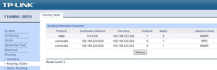

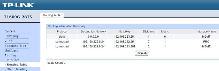

    2. TABLES DE ROUTAGE
      SWITCH
      Protocol Destination Network Next Hop
      static 0.0.0.0/0 192.168.223.254
      connected 192.168.223.0/24 192.168.223.253
      connected 192.168.222.0/24 192.168.222.254

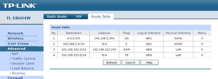

    3. Donc voici la table de routage du routeur:
      TABLE ROUTEUR TPLINK
      Destination Gateway Logical Interface
      0.0.0.0/0 192.168.2.254 eth1 WAN1
      192.168.2.0/24 N/A eth1 WAN1
      192.168.222.0/24 192.168.223.253 eth0 LAN
      192.168.223.0/24 N/A eth0 LAN
