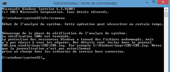

    En parallèle j'ai lancé une analyse de la « Protection des ressources Windows ... :
    1- Démarrer une « Invite de commande en mode « Administrateur »
    puis taper : Sfc/scannow
    Nota : La commande sfc /scannow analyse tous les fichiers système protégés et remplace les fichiers endommagés par une copie mise en cache dans un dossier compressé windows.
    Voir le résultat ci-dessous
    La log me fournit pour notre utilitaire : 1 erreur non-réparées (x4 fois le même message):
    Voici les 4 erreurs :
    2015-10-22 12:21:49, Info CSI 000005d0 [SR] Cannot repair member file [l:36{18}]"Amd64\CNBJ2530.DPB" of prncacla.inf, Version = 6.3.9600.17415, pA = PROCESSOR_ARCHITECTURE_AMD64 (9), Culture neutral, VersionScope = 1 nonSxS, PublicKeyToken = {l:8 b:31bf3856ad364e35}, Type = [l:24{12}]"driverUpdate", TypeName neutral, PublicKey neutral in the store, hash mismatch
    2015-10-22 12:21:55, Info CSI 000005d2 [SR] Cannot repair member file [l:36{18}]"Amd64\CNBJ2530.DPB" of prncacla.inf, Version = 6.3.9600.17415, pA = PROCESSOR_ARCHITECTURE_AMD64 (9), Culture neutral, VersionScope = 1 nonSxS, PublicKeyToken = {l:8 b:31bf3856ad364e35}, Type = [l:24{12}]"driverUpdate", TypeName neutral, PublicKey neutral in the store, hash mismatch
    2015-10-22 12:21:55, Info CSI 000005d3 [SR] This component was referenced by [l:166{83}]"Package_2709_for_KB3000850~31bf3856ad364e35~amd64~~6.3.1.8.3000850-6825_neutral_GDR"
    2015-10-22 12:28:18, Info CSI 00000942 [SR] Cannot repair member file [l:36{18}]"Amd64\CNBJ2530.DPB" of prncacla.inf, Version = 6.3.9600.17415, pA = PROCESSOR_ARCHITECTURE_AMD64 (9), Culture neutral, VersionScope = 1 nonSxS, PublicKeyToken = {l:8 b:31bf3856ad364e35}, Type = [l:24{12}]"driverUpdate", TypeName neutral, PublicKey neutral in the store, hash mismatch
    2015-10-22 12:28:18, Info CSI 00000944 [SR] Cannot repair member file [l:36{18}]"Amd64\CNBJ2530.DPB" of prncacla.inf, Version = 6.3.9600.17415, pA = PROCESSOR_ARCHITECTURE_AMD64 (9), Culture neutral, VersionScope = 1 nonSxS, PublicKeyToken = {l:8 b:31bf3856ad364e35}, Type = [l:24{12}]"driverUpdate", TypeName neutral, PublicKey neutral in the store, hash mismatch
    2015-10-22 12:28:18, Info CSI 00000945 [SR] This component was referenced by [l:166{83}]"Package_2709_for_KB3000850~31bf3856ad364e35~amd64~~6.3.1.8.3000850-6825_neutral_GDR"
    2015-10-22 12:28:18, Info CSI 00000946 [SR] Repair complete
    2015-10-22 12:28:18, Info CSI 00000947 [SR] Committing transaction
    Note : Le fichier CBS.log a une structure spécifique et lors du passage de l'utilitaire ci-dessus, il enregistre en même temps d'autres évènements CBS... donc il faut rechercher dans la log les paragraphes contenant le Tag [SR] et créer un fichier « résultat de la recherche » qui sera plus facile à lire :

    findstr /c:"[SR]" \windows\Logs\CBS\CBS.log >C:\users\jlo\Desktop\sfcdetails.txt
