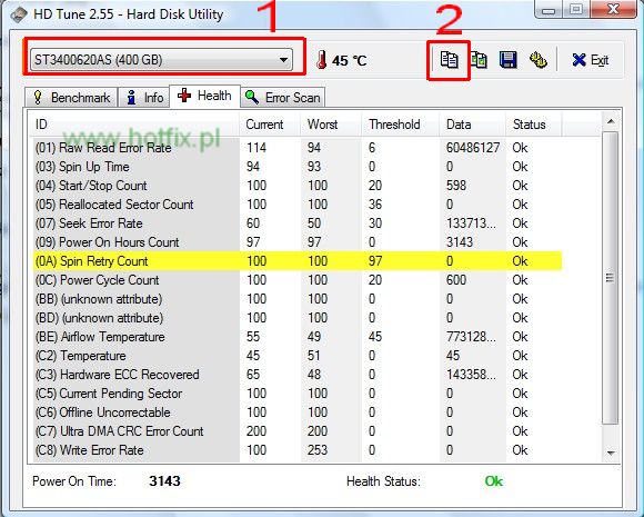

    1. Ce sont les caractéristiques de ton disque. Ce n'est pas ce qui m'intéresse. C'est plus un rapport de ce genre que j'aimerais :
      http://www.hotfix.pl/ck/HDTune.jpg

      HD Tune Pro: ST1000DM003-1ER162 Health
      ID Current Worst ThresholdData Status
      (01) Raw Read Error Rate 119 99 6 203337168 ok
      (03) Spin Up Time 97 97 0 0 ok
      (04) Start/Stop Count 100 100 20 410 ok
      (05) Reallocated Sector Count 100 100 10 0 ok
      (07) Seek Error Rate 80 60 30 107099629 ok
      (09) Power On Hours Count 94 94 0 5476 ok
      (0A) Spin Retry Count 100 100 97 0 ok
      (0C) Power Cycle Count 100 100 20 395 ok
      (B7) SATA Downshift Count 100 100 0 0 ok
      (B8) End To End Error Detection 100 100 99 0 ok
      (BB) Uncorrectable Error Count 100 100 0 0 ok
      (BC) Command Timeout 100 100 0 0 ok
      (BD) Unknown Attribute 99 99 0 1 ok
      (BE) Airflow Temperature 73 60 45 488243227 ok
      (BF) G-sense Error Rate 100 100 0 0 ok
      (C0) Unsafe Shutdown Count 100 100 0 3 ok
      (C1) Load Cycle Count 76 76 0 49119 ok
      (C2) Temperature 27 40 0 51539607579 ok
      (C5) Current Pending Sector 100 100 0 0 ok
      (C6) Offline Uncorrectable 100 100 0 0 ok
      (C7) Interface CRC Error Count 200 200 0 0 ok
      (F0) Head Flying Hours 100 253 0 31065498457115 ok
      (F1) Unknown Attribute 100 253 0 24943745302 ok
      (F2) Unknown Attribute 100 253 0 119182923606 ok
      Health Status : ok
