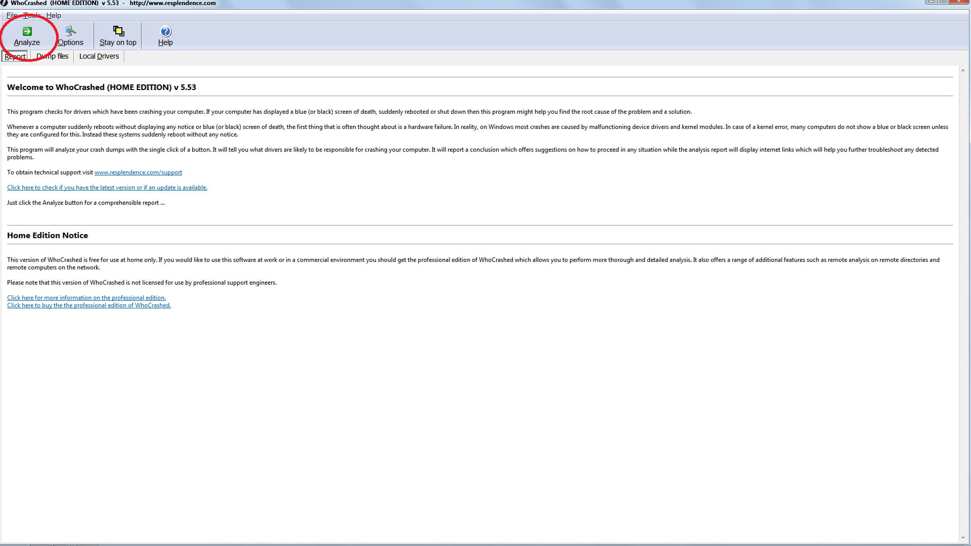

    Essai et télécharge WhoCrashed
    Et fais ANALYZE
    après l'analyse , en bas à gauche tu devrais avoir (s'il y en a) un rapport (tu le colle dans ta réponse)

      Du coup j'ai téléchargé WhoCrashed et j'ai eu ça :
      Windows dir: C:\Windows
      Hardware: ASUSTeK COMPUTER INC., M5A97 R2.0
      CPU: AuthenticAMD AMD FX(tm)-6300 Six-Core Processor AMD586, level: 21
      6 logical processors, active mask: 63
      RAM: 8482770944 bytes total
      Crash Dump Analysis
      Crash dump directory: C:\Windows\Minidump
      Crash dumps are enabled on your computer.
      No valid crash dumps have been found on your computer
      Conclusion
      Crash dumps are enabled but no valid crash dumps have been found. In case you are experiencing system crashes, it may be that crash dumps are prevented from being written out. Check out the following article for possible causes: If crash dumps are not written out.

      Voilà ça a crash à nouveau, j'ai fais le test et ca me dit ça
      Crash Dump Analysis
      On Thu 26/01/2017 12:27:21 your computer crashed
      crash dump file: C:\Windows\Minidump\012617-14554-01.dmp
      This was probably caused by the following module: Unknown ()
      Bugcheck code: 0x0 (0x0, 0x0, 0x0, 0x0)
      Error: CUSTOM_ERROR
      A third party driver was identified as the probable root cause of this system error.
      Google query: CUSTOM_ERROR
