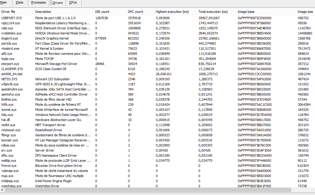

Solution testé qui [u]ne fonctionne pas[/u]:
-Formatage de Windows 10
-Re-formatage et basculement a Windows 8.1
-MAJ des drivers
-Désactivation de certains périphériques
-Désactivation de certaines options dans le BIOS
-Test de la RAM / HDD / SDD & vérif si MAJ firmware RAS
Logiciel utilisé:
-Vérification de la RAM par windows (10 tests effectués) RAS

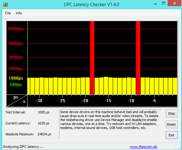

-DPC Latency qui n'est pas 100% compatible avec Win 8.1 mais qui me trouve des pics de latence lier a mon problème (Voir photo 1)

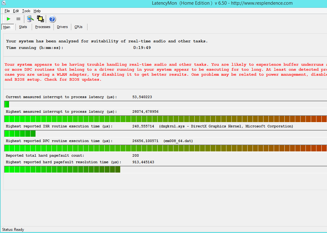

-Et LatencyMon (je vous montre le résumer, voir photo 2,3 & la quote)
Si vous avez une idée partager !
Photo 1
https://www.zupimages.net/up/16/41/xhvs.png
Photo 2 , 3
https://www.zupimages.net/up/16/41/gmvo.png
https://www.zupimages.net/up/16/41/w1n1.png
CONCLUSION
_________________________________________________________________________________________________________
Your system appears to be having trouble handling real-time audio and other tasks. You are likely to experience buffer underruns appearing as drop outs, clicks or pops. One or more DPC routines that belong to a driver running in your system appear to be executing for too long. At least one detected problem appears to be network related. In case you are using a WLAN adapter, try disabling it to get better results. One problem may be related to power management, disable CPU throttling settings in Control Panel and BIOS setup. Check for BIOS updates.
LatencyMon has been analyzing your system for 0:19:49 (h:mm:ss) on all processors.
