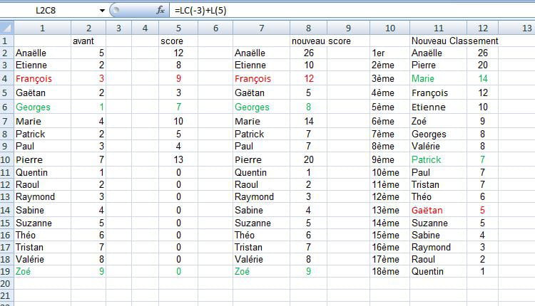

I'm creating a macro. I know how to do it. Well, not completely since I'm reaching out to you. :-)
During the macro, I want to sort. However, some cells have red characters, while others have green ones. When I look at what the macro produced, I see the colors, but not in the correct cells.
What am I missing?
Thank you for your responses.

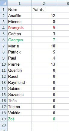

  3. Philbert29 Posted messages 48 Registration date   Status Member Last intervention   2
    Hello
    I don't know if this is what you want.
    I took a screenshot of the Excel sheet after using the macro. You can see that the colors are not with the correct cell.
    And the screenshot of the concerned macro, hoping that this is what you want.
    Thank you for your help.
  4. Bruno83200_6929 Posted messages 725 Registration date   Status Member Last intervention   171
    Re suite...
    Thanks for the screenshot, it’s very revealing
    And now, we can be much more precise.
    What you observe confirms this 99%:
    You are sorting the values, but NOT the entire range (or not correctly linked)
    The classic error in VBA
    Very often, we have code like this:
    Range("B2:B20").Sort Key1:=Range("B2"), Order1:=xlDescending
    This only sorts the score column
    BUT NOT the names next to it
    What you need to do
    You must sort the entire area, for example:
    Range("A2:B20").Sort Key1:=Range("B2"), Order1:=xlDescending, Header:=xlNo
    There:
    the names
    the values
    the colors
    everything stays aligned
    Clean version (recommended)
    Even better:
    With ActiveSheet.Sort .SetRange Range("A2:B20") .SortFields.Clear .SortFields.Add Key:=Range("B2:B20"), Order:=xlDescending .Header = xlNo .Apply End With
    Simple little test
    To check on your end:
    Take your table
    Do a manual sort in Excel (Data menu → Sort)
    If everything remains OK → your VBA is the issue
    If it breaks too → structural problem

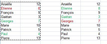

  5. Philbert29 Posted messages 48 Registration date   Status Member Last intervention   2
    I understand what you're telling me, but I can't do it.
    When I do it manually, the first names have the correct score but not the right color.
    I do columns 1-2 Ctrl C, then 4-5 paste special values
  6. Bruno83200_6929 Posted messages 725 Registration date   Status Member Last intervention   171
    Why isn't it working
    When you do:
    special paste → values
    Excel copies:
    the numbers
    the text
    NOT the formats (so not the colors)
    So:
    the scores are right
    the first names are right
    the colors remain the same as before
    THE SOLUTIONS (depending on your need)
    Solution 1 — Copy WITH formats (the simplest)
    Instead of:
    Special paste → Values
    do:
    Special paste → Values + formats
    Solution 2 — Copy only the formats afterwards
    Paste the values
    Then redo:
    Special paste → Formats

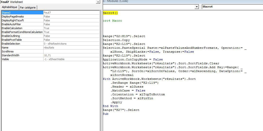

  7. Philbert29 Posted messages 48 Registration date   Status Member Last intervention   2
    I am indeed going to ask you to correct my macro.
    For your information, and this may be the reason, the cell values come from another sheet.
    I am therefore sending you sheet 1, sheet 2 with the indication for one cell of the formula (the others below are similar and with the use of the macro that desperately does not want to keep the correct colors.
    And
    of course the macro.
    Thank you
  8. Bruno83200_6929 Posted messages 725 Registration date   Status Member Last intervention   171
    Thank you!
    Your mistakes:
    Your macro does this:
    Selection.PasteSpecial Paste:=xlPasteValuesAndNumberFormats
    Problem:
    You are copying values + number formats
    BUT NOT the font colors
    And there is a second problem
    You are doing a .Select + Selection
    This is:
    fragile
    a source of errors
    unnecessary
    THE SIMPLE FIX (your corrected macro)
    Sub Macro4() Dim ws As Worksheet Set ws = ActiveWorkbook.Worksheets("results") ' Full copy (WITH colors) ws.Range("G2:H19").Copy Destination:=ws.Range("K2") ' Clean sort With ws.Sort .SortFields.Clear .SortFields.Add Key:=ws.Range("L2:L19"), _ SortOn:=xlSortOnValues, Order:=xlDescending, DataOption:=xlSortNormal .SetRange ws.Range("K2:L19") .Header = xlNo .MatchCase = False .Orientation = xlTopToBottom .SortMethod = xlPinYin .Apply End With End Sub
    IMPORTANT (in YOUR specific case)
    You say:
    the values come from another sheet
    So:
    the colors do NOT come from formulas
    they are already in G:H
    so the full copy is the right solution
    If you want to go further
    You can also:
    automate the colors according to the score (much more robust)
    or
    simplify your whole system (fewer intermediate columns)
    You are already very close to something clean
    If you need any help, let me know!

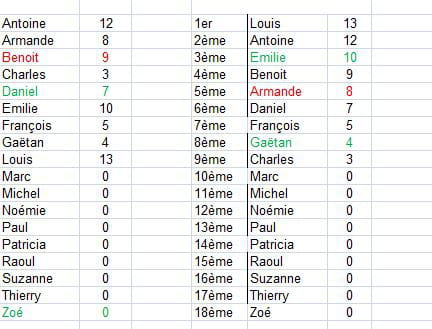

  9. Philbert29 Posted messages 48 Registration date   Status Member Last intervention   2
    Good evening
    Clearly, I really can't manage it, no matter the method.
    I can't get the color to stay fixed for the two adjacent cells.
    If the color works, then the number values are wrong, and if the numbers are correct, the green and red colors wander all over the place, and that adds to it! ?
    https://docs.google.com/spreadsheets/d/1G8uUYFA4qVpF71UWx_v9nc_Y3SZhTgeAW921CxSoJkk/edit?usp=sharing
    I'm giving you the link to the file. If you can write the macro. Thank you

    Step 3 — SIMPLIFIED Macro (without format copying)
    Here’s YOUR clean macro:
    Sub Classement_Propre() ``` Dim ws As Worksheet Set ws = ThisWorkbook.Worksheets("résultats") ' Copy only values (not formats!) ws.Range("K2:L19").Value = ws.Range("G2:H19").Value ' Sort With ws.Sort .SortFields.Clear .SortFields.Add Key:=ws.Range("L2:L19"), _ Order:=xlDescending .SetRange ws.Range("K2:L19") .Header = xlNo .Apply End With ``` End Sub
    Why it works (and why it bugs for you)
    Before:
    you copied colors → they shifted
    or you lost them → inconsistency
    Now:
    you only copy the data
    the colors recalculate automatically
    the sorting doesn’t break anything
    Final result
    You can:
    sort 100 times
    change the values
    restart the macro
    The colors will ALWAYS be correct

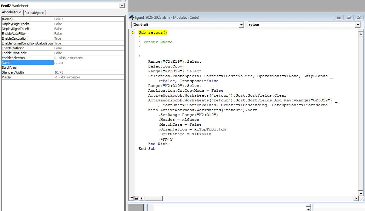

  12. danielc0 Posted messages 2192 Registration date   Status Member Last intervention   287
    Hello,
    On which sheet are you sorting? From reading your code, you are basing it on columns J and K which do not contain color. Please explain exactly what you want to do.
