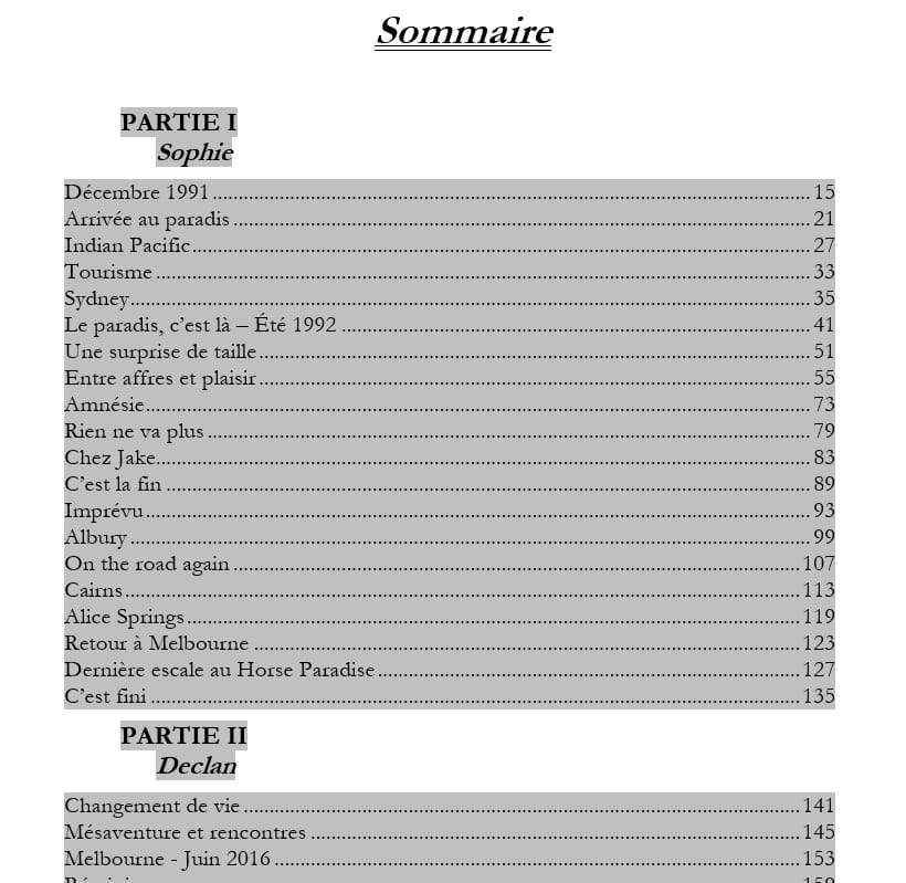

Hello,
In my table of contents, I've created my styles and everything is working well, except for one of the styles (Section Title), where I would like the page number not to appear since it is identical to that of the previous style (Section Number).
I searched and found a slew of answers with elements that do not appear in my Word (2024). For example, "it" suggests unchecking the "include page number" box after displaying a dialog box to mark the entry (Alt Shift O), but this field doesn't exist and I'm stuck. Of course, it's not a big deal, but having the same page number twice one below the other isn't very ideal... even though I'll probably be the only one to notice it ;-).
Thank you for any solution on this matter.

  7. Cathozie Posted messages 104 Registration date   Status Member Last intervention   6
    Hello m@rina and thank you for your response,
    Here is the TOC of my TM:
    { TOC \h \z \t "Chapter Title;1;Part Title;2;PART number;1;Sub-chapter;3" }
    This gives me:
    PART number...............................................................13
        Part Title                                                                    13
           Sub-chapter................................................................15
    I looked at your pages and for tonight, I'm going to let it go, but what I would like (I'll try tomorrow) is for the Part Title line not to have a number or trailing dots. For now, there are no trailing dots and that's very good, but I didn’t understand why.
    I’ll get back to you tomorrow after testing.

  8. Cathozie Posted messages 104 Registration date   Status Member Last intervention   6
    So I realize that the first style in the TOC didn't belong there.
    So here is the reality of the TOC:
    { TOC \h \z \t "PART number;1;Part Title;2;Sub-chapter;3" }
    Which gives me:
    PART number. (this is the name of the level 1 style). .................................13
        Part Title (this is the name of the level 2 style)                                       13
           Sub-chapter (this is the name of the level 3 style)....        .........................15
  9. Cathozie Posted messages 104 Registration date   Status Member Last intervention   6
    In the TOC, I tried to enter the switch \n 2-2, but it doesn't work, it only leaves me the PART I, PART II... (style PART number) and the chapter numbers which are not even included in the TOC style.
    { TOC \h \z \t \n 2-2 "PART number;1;Part Title;2;Sub-chapter;3" }
    This gives:
    PART I...............................................................13
        1........................................................................15
        2........................................................................15
        3........................................................................15
  10. Cathozie Posted messages 104 Registration date   Status Member Last intervention   6
    Hello,
    Title 1, Title 2... it doesn’t speak to me, so I name my styles so that they appear to me without having to remember... It's age :-).
    You are absolutely right, it’s the PART number style that should be without page number, and in that case, there should be dots on the Partie Title line and not on the PART number line.
    Here is an excerpt from the novel with TM:
    https://fromsmash.com/Table-des-matieres-et-extrait
  11. Cathozie Posted messages 104 Registration date   Status Member Last intervention   6
    https://fromsmash.com/Table-of-contents-and-excerpt
  12. Cathozie Posted messages 104 Registration date   Status Member Last intervention   6
    Good evening m@rina and a huge thank you for this work on my style hierarchy.
    I didn't understand why I had to remove the levels from the styles I didn't want to see every time I made a TM change.
    They kept reappearing every time.
    I'll look into the issue more closely tomorrow, and in the meantime, wish you a good evening.
    Catherine :-)

  13. Cathozie Posted messages 104 Registration date   Status Member Last intervention   6
    Hello m@rina,
    There you go! I have completed the alignment... of my TOC with the Title 1 styles... and I have removed all the "hacked" styles.
    I ultimately decided to remove the page numbering from Title 1 and Title 2, which doesn't really make much sense. However, even after correcting my TOC with the information from your example, I still had continuation points on the first level (Title 1), but not on the second level like in your example, regardless of the TOC style inserted (whether the proposed ones or the custom one). I corrected it by ending the TOC with \n 1-2 and applied a TM style that highlights these two levels differently.
    Regarding the TM1, TM2 styles... is it normal that they don't remain when updating the TOC, or is there some manipulation to keep them with each update of the TOC?
    One last thing, if you don’t mind. When I use the custom style, in the options, if "Styles" is checked, I no longer have my unwanted styles since I deleted them, but there are still two header styles that I didn't create: Header #1 which has level 1 and Header #2 (2) which has level 2 and, every time I retest, they reappear, even though I have removed the levels. By unchecking "Styles" and keeping "Hierarchical levels," it works, so that's what I did, but I would like to understand.
    That's it! Thank you so much for your patience and valuable help.
    Have a great day.
    Catherine :-)
